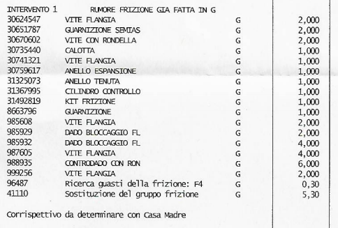

Ok guys, I got the car back from the service. Here follows the list (codes) of the spares replaced (under warranty, no money spent) and relative quantities. I'll keep my finger crossed and hope that the moaning noise won't come back anytime soon.
