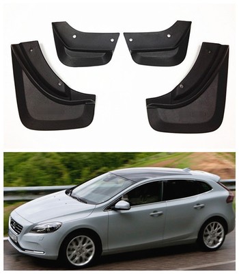

I got the fake ones from China on ebay for £40. Fronts are exactly the same as genuine ones and fit perfectly. Rears are slightly different around the mounting holes and need a bit of fettling (still not got round to it yet).
Whatever mud flaps you get, I would suggest putting some clear vinyl on the sill or bumper under where they overlap the paint before you fit them. It stops any grit that gets down between the rubber and painted surface damaging the paintwork. I put some paper inside the lip of the flap and drew around the outer edge, then used that as a template to cut some external-quality clear vinyl to shape.

£40 for a full set that looks just as good as the real thing is a great find, especially seeing as Volvo charge £55 just for the fronts.

wilkhaven has some great pictures of the cheap as chips Chinese copies fitted but I think they are all about the same
64 Posts
Indeed, as has been said before they were cheap off Ebay and appear to be genuine Volvo. Fitting was as simple as it gets!
Volvo wouldn't supply the rear as they say they're not compatible with the R design, still can't work out why!
They are very good at stopping the crud from country lanes caking the sills and the lower rear bumper only.
