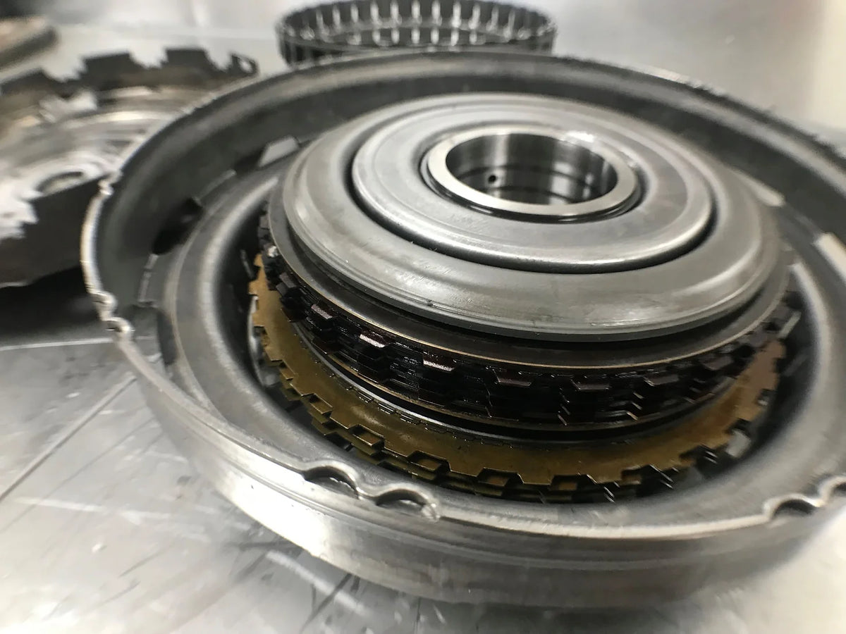

Are the clutches built into the gearbox , reason I’m asking is I thought about getting a clutch put in while the gearbox is out like you would with a manual but they probably work in a different way ?
